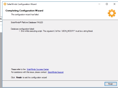

This is what the error looks like:
Before proceeding with the workaround in this article, open C:\ProgramData\Solarwinds\Logs\Orion\ConfigurationWizard.log and look for an error that contains similar verbiage to the following error message:
2024-03-28 14:20:28,306 [10] ERROR DBConfigProcessor - Error while executing script - The argument 2 of the "JSON_MODIFY" must be a string literal..
 Error details: System.Data.SqlClient.SqlException (0x80131904): The argument 2 of the "JSON_MODIFY" must be a string literal.
