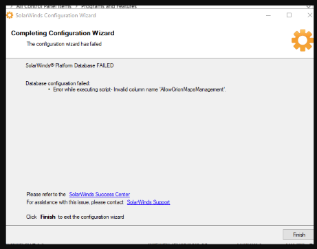

After performing an upgrade to SolarWinds Platform 2023.4, the Configuration Wizard fails with the following error:
The following can also be found in the ConfigurationWizard.log file located in C:\ProgramData\SolarWinds\Logs\Orion\:
ERROR TaskAdapter - Error running task Orion.ConfigureDatabase SolarWinds Platform Database SolarWinds.ConfigurationWizard.Common.ConfigurationException: Error while executing script- Invalid column name 'AllowOrionMapsManagement'.
