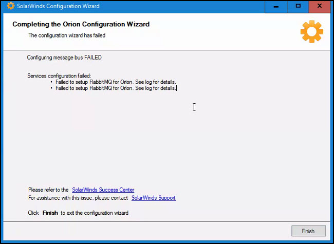

Error 1:
Configuring message bus FAILED
Services configuration failed:
 • Failed to setup RabbitMQ for Orion. See log for details.

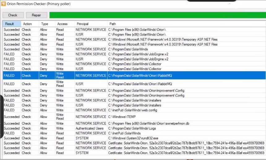

Run the Orion Permission Checker. Please refer to Check permissions using the Orion Permission Checker. Click repair in the Orion Permission Check and make sure that the user has read/write access to RabbitMQ. Re-run the configuration wizard.

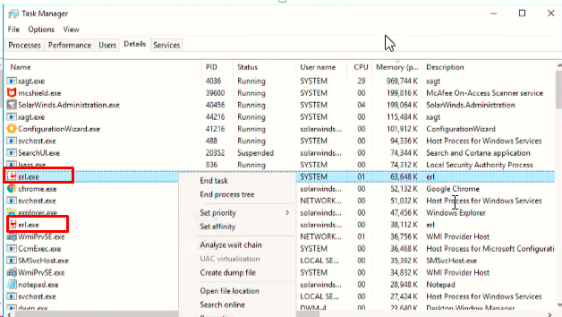

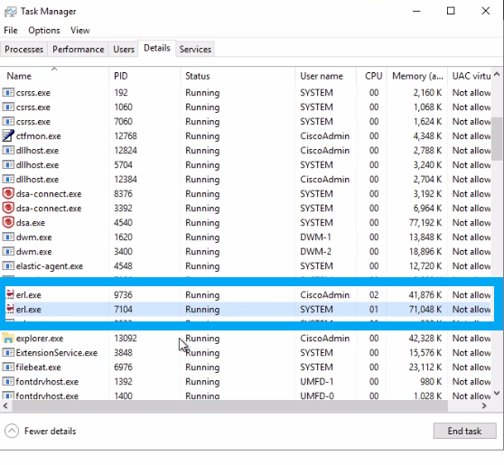

Anti Virus. Check erl.exe in Task Manager\Details if the process is not being blocked. Kindly refer to the sample screenshot below.
(Screenshot property of © 2019 Microsoft)

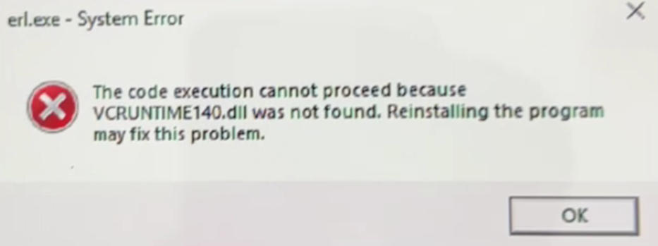

  • Ran RabbitMQ Manually and will see an error for The code execution cannot proceed because VCRUNTIME140.dll was not found. Reinstalling the program may fix this problem.
1. RDP to the Orion Server.
2. Go to the path C:\Windows\System32.
3. Check for the following files if present:
  • VCRUNTIME140.DLL.
  • VCRUNTIME140_1.DLL
  • VCRUNTIME140_clr0400.DLL
The content posted herein are provided as a suggestion or recommendation to you for your internal use. The information set forth herein may come from third-party website or customers. SolarWinds is not liable for any downtime or any issue that may occur if you perform the following suggestions on the link provided. Your organization should internally review and assess to what extent, if any, such custom scripts or recommendations will be incorporated into your environment.
4. If the files are missing, if the customer has a working server that has the same OS, you may ask the customer to copy the file and move it to the Orion Server.
5. Once done, reboot the server.
6. Re-run the Configuration Wizard and  the Task Manager will now show erl;.exe.
7. The Configuration Wizard will now be complete with no errors for Configuring message bus FAILED. Failed to setup RabbitMQ for Orion. See log for details.
