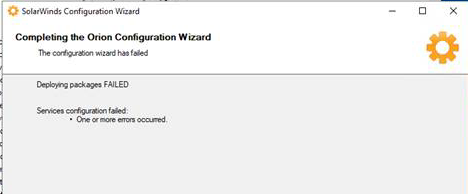

Orion Configuration Wizard Fails: Deploying packages FAILED. Services Configuration failed: one or more errors occurred
The article discusses how to address the issue when error prompts during a run of the Configuration Wizard
