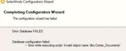

Configuration Wizard Error while executing script- Invalid object name 'dbo.Cortex_Documents'
ERROR TaskAdapter - Error running task Orion.ConfigureDatabase Orion Database SolarWinds.ConfigurationWizard.Common.ConfigurationException: Error while executing script- Invalid object name 'dbo.Cortex_Documents'.
10/25/2022 3:41 PM
10/25/2022 3:41 PM
While upgrading from 2020.2.5 to 2022.3 (HCO), you me see following error during Configuration Wizard run when it reaches 21.1% (DB config stage).
Following error is noted in CW log.
2022-10-25 12:19:49,957 [17] ERROR TaskAdapter - Error running task Orion.ConfigureDatabase Orion Database
   at SolarWinds.ConfigurationWizard.Plugin.Common.DBConfigProcessor.ExecuteSqlBatch(IDbConnection connection, String sqlQuery, ConfigurationLogDelegate configLog)
   at SolarWinds.ConfigurationWizard.Plugin.Common.DBConfigProcessor.Process(IDbConnection connection, ConfigurationProgressDelegate progress, String scriptFile, ConfigurationLogDelegate logger)
Orion Platform
Solarwinds Application is pointed to wrong/broken DB
Please verify that Solarwinds is pointing to the correct DB by checking dbo.Cortex_Versions & dbo.Cortex_Documents tables exists or not.
Re-run the Configuration wizard and choose the right DB
If the DB is corrupted/Broken, then you may need to create a new DB and use that instead during Config Wizard.
