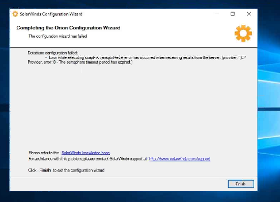

When you execute the SolarWinds Platform Configuration Wizard, the process fails with the following error message: Database configuration failed: Error while executing script - A transport-level error has occurred when receiving results from the server. (provider: TCP Provider, error: 0 - The semaphore timeout period has expired.)

During the execution of the SolarWinds Platform Configuration Wizard, the process may fail and display the error:
Database configuration failed:  Error while executing script- A transport-level error has occurred when receiving results from the server. (provider: TCP Provider, error: 0 - The semaphore timeout period has expired.)
Network Performance Monitor
The work to configure the database did not complete in the requested time.
