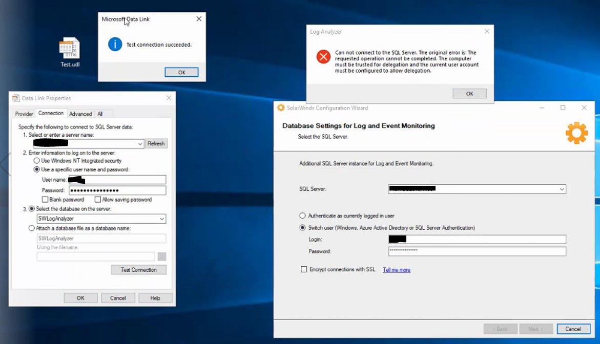

When running the configuration wizard, the following error message may appear:
Can not connect to the SQL Server. The original error is: The requested operation cannot be completed. The computer must be trusted for delegation and the current user account must be configured to allow delegation.
Network Performance Monitor
This issue occurs due to a group policy object causing issues.
  1. Do the UDL Test first to confirm the credentials have a connection to the SQL Server: Verify the SQL and Orion server connectivity using the UDL file
  2. If there are no issues with the connection, make sure to log in to the Orion server as a Local Admin Account to make sure that there are no other security policies being enforced that may cause the error in the process of installation / upgrade. Take note that Domain Admin accounts are still subject to Group Policy Objects.
Alternatively, switch from Windows Authentication to SQL Authentication as a workaround.
