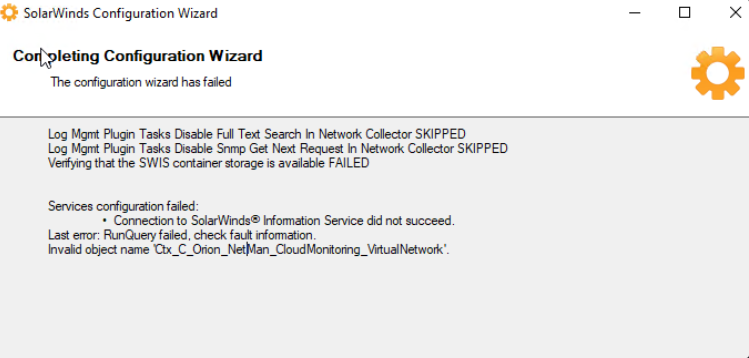

"Invalid object name 'Ctx_C_Orion_NetMan_CloudMonitoring_VirtualNetwork'" error in Configuration Wizard
You may see the error Invalid object name 'Ctx_C_Orion_NetMan_CloudMonitoring_VirtualNetwork' in logs when running the Configuration Wizard (CW). In some cases Configuration Wizard fails with this error; in other cases CW completes successfully and the error only appears as transient SWIS log entries. This behavior is currently under investigation by Engineering.
When you run the Configuration Wizard, you may see the following in the ConfigurationWizard.log and Orion.InformationService.log:

If the Configuration Wizard fails and you cannot complete the configuration, perform the following steps:
