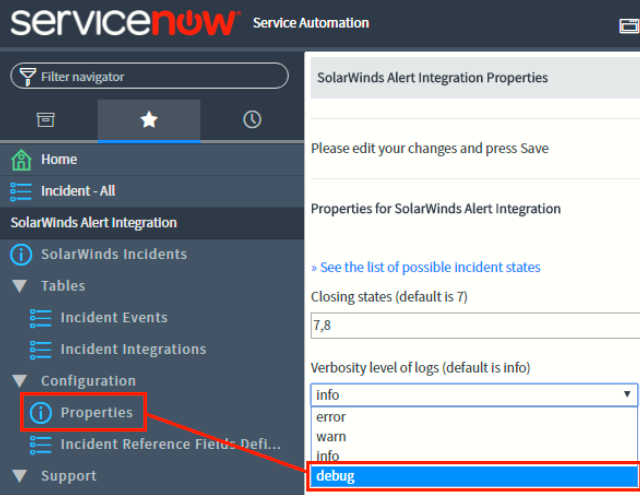

  1. Locate SolarWinds Alert Integration / Configuration / Properties page in ServiceNow.
  2. Set log verbosity to debug and press Save. (Picture 1)

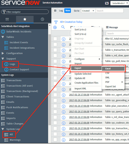

  1. Locate SolarWinds Alert Integration / Support / Logs and System Logs / System Log / All in ServiceNow.
  2. In both tables should be log records.
  3. Export data to Excel, an option is available in column menu Export / Excel. (Picture 2)
