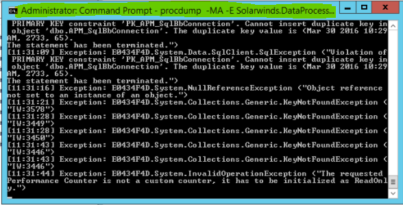

  4. Use one of the following formats to enter a command. Various options are described below.
    procdump -MA -E PID
    or
    procdump -MA -E PROCESSNAME
    Note: If you run the command without -E, the utility will collect the current process dump without waiting for the process or service to crash. This command will create a process dump for the named process when it crashes. Results will be stored in the folder where you installed the ProcDump utility.
