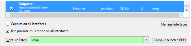

    3. Select the interface for your NetPath outgoing traffic

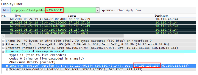

    4. Apply capture filter icmp Capture filter
    5. . Apply display filter (icmp.type == 11 and ip.dst == <endpoint  ip>)
            note: replace the blue string in the above filters with your own data.
      Display Filter

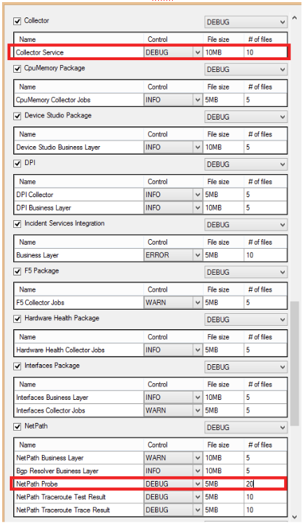

  1. Enable debug for NetPath probe.
    1. If NetPath probe is an Orion Server, use Log Adjuster to enable debug for NetPath probe. Please make sure you Reset to default after we collect the diags.
If NetPath probe is an Orion Agent, go to Web Console > Settings > All Settings > Manage Agents > Select the netpath agent > Edit Settings > Enable Debug > Submit
After that change wait 2 polling intervals and navigate back to Settings > Manage Agents > Select the netpath agent > Edit Settings you can expand Troubleshooting and click Collect new diagnostics as seen above
After a few moments, the Download link will appear and you can download the diagnostics

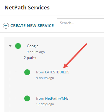

Load the network path
  1. Click My Dashboards > Network > NetPath Services
  2. Expand a service, and click a probe link.
  3. Under Path History, click an interval to see the graph from that date and time.
