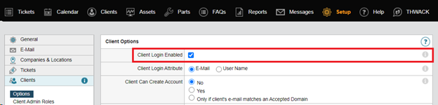

If the Client Login Enabled settings were set to NO, the Web Help Desk would not allow to login to the application using the web interface. By design, these settings can modify or change from Web help desk GUI by navigating to Setup> Client>Options.
However, in this scenario, the Tech set these settings to NO then log out. After the changes, he cannot log in due to multiple incorrect attempts, and the All Clients are unable to login.
