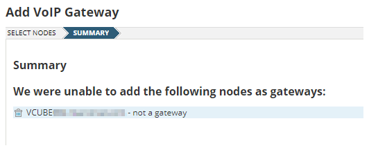

When trying to add a Cisco gateway to VNQM, the gateway cannot be added and VNQM displays an error that this device is not a gateway as similarly shown below:

  • OIDs required by VNQM to add a gateway media are not present in the device MIBs.
The following OIDs are required:
// ISDN-MIB - isdnSignalingGetIndex
SnmpValueType ("1.3.6.1.2.1.10.20.1.3.1.0", SnmpValueType.INTEGER)
// DIAL-CONTROL-MIB:callHistory -callHistoryTableMaxLength
SnmpValueType ("1.3.6.1.2.1.10.21.1.4.1.0", SnmpValueType.INTEGER)
// IF-MIB:ifTableLastChange
SnmpValueType>("1.3.6.1.2.1.31.1.5.0", SnmpValueType.TIMETICKS)
The wizard executes one “detector” job and this process:
  1. At first, it checks whether  IsSnmpA is available by the presence of the following OID:
    • SysContactOid = "1.3.6.1.2.1.1.4.0"
  2. Then, it checks for MediaGatewayOIDs:
  • //ISDN-MIB - isdnSignalingGetIndex
"1.3.6.1.2.1.10.20.1.3.1.0", SnmpValueType.INTEGER,
  • // DIAL-CONTROL-MIB:callHistory -callHistoryTableMaxLength
"1.3.6.1.2.1.10.21.1.4.1.0", SnmpValueType.INTEGER,
  • // IF-MIB:ifTableLastChange
If all of the OIDs are present and the values have the correct type (SnmpValueType), the device is defined as a valid MediaGateway which can be added as a gateway.
