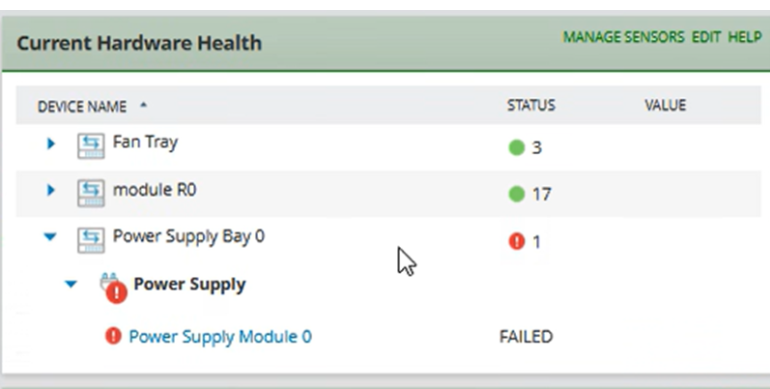

Cisco Router 8200 (v17.6.5) Power Supply Module is showing Failed in the SolarWinds Platform
This article shows why Cisco Power Supply Module is showing Failed in Current Hardware Health widgets

 This article shows why Cisco Power Supply Module is showing Failed in Current Hardware Health widgets and the possible cause.
The customer is using Cisco Router 8200 (v17.6.5)
From the SNMPWalk to the device we see the following OID:
.1.3.6.1.4.1.9.9.117.1.1.2.1.2.3 = INTEGER: 8
.1.3.6.1.4.1.9.9.117.1.1.2.1.2.3 (cefcFRUPowerOperStatus): Integer 8 indicates the status is notPowered (or potentially faulty/unplugged).

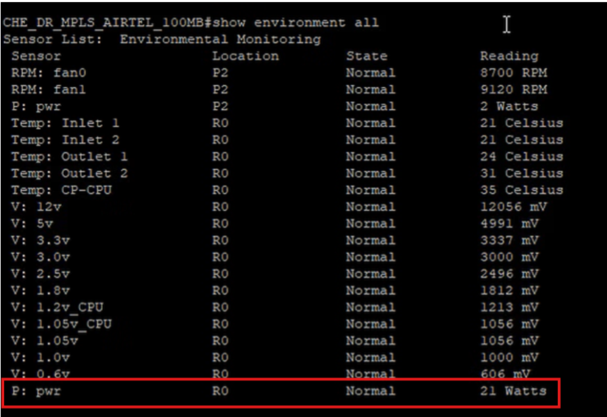

Why this is happening
  1. False-Positive SNMP: The device's management plane is reporting a faulty status (8) for a power module, even though show environment power (CLI) shows ok or normal.
  2. Bug: This is often caused by a software bug in IOS-XE  (reported in 17.6).
