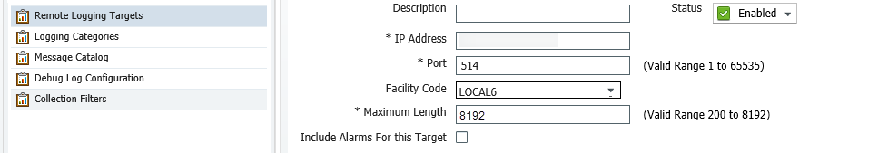

Open a web browser to Cisco ISE, and configure it for larger packets:  Set the max length = 8192.
The following is just an example, as the IP should be the SEM, the port should be 514, and specify the Facility Code 'syslog filename'.

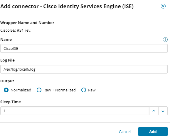

Ensure your connector is configured correctly in SEM.
