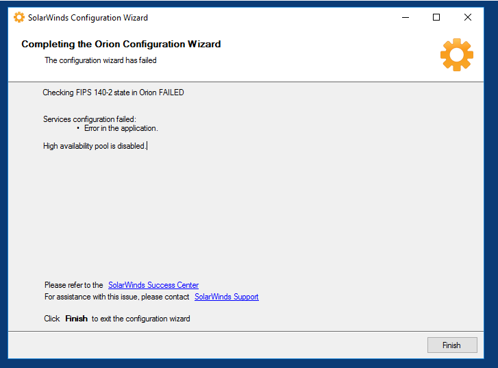

When running the configuration wizard, this may fail with the following error message:
ERROR TaskAdapter - Error running task Orion.CheckFips Checking FIPS 140-2 state in SolarWinds Platform System.ComponentModel.Win32Exception (0x80004005): Access is denied
Also, you will notice access denied errors in SolarWinds Services logs during services startup, and the Module engine fails to load all plugins.

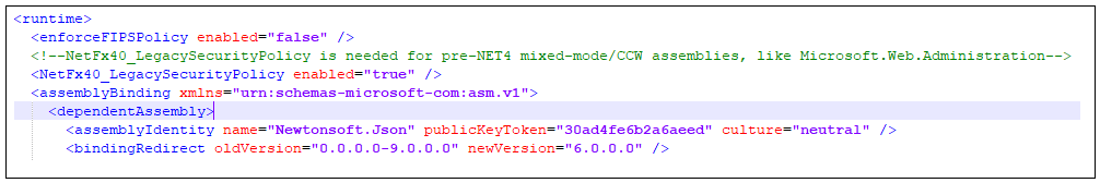

Solution 2: Disable FIPS in Configuration Wizard
  1. Edit the ConfigurationWizard.exe.config (Found in C:\Program Files (x86)\SolarWinds\Orion)
  2. Verify if this line <enforceFIPSPolicy enabled="false" /> is existing in the config
    If not, please add it in the below section.
<runtime>
    <!--NetFx40_LegacySecurityPolicy is needed for pre-NET4 mixed-mode/CCW assemblies, like Microsoft.Web.Administration-->
    <NetFx40_LegacySecurityPolicy enabled="true" />
It should look like below.
  1. Save the config
  2. Re-run the Configuration Wizard
