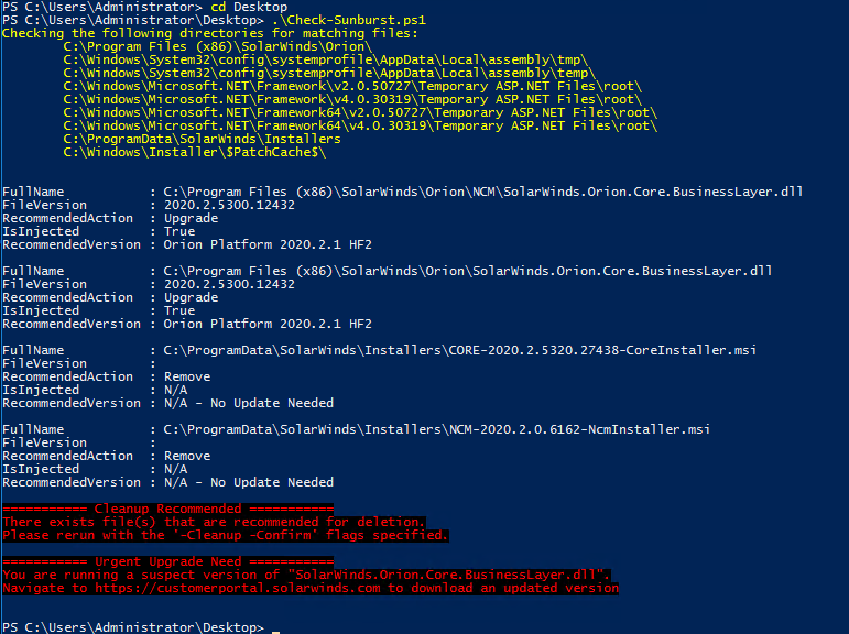

If you are running an affected version of SolarWinds Orion Platform products, you will see script output like the following:
As shown in the example above, there are two recommended actions:
  • Cleanup – This will remove affected installers and/or cached libraries.
  • Upgrade – The recommended version in this case is 2021.2.1 HF2, but SolarWinds strongly recommends upgrading to the latest available version, as there is a chance that a newer version was released and was not available at the time this script was created.

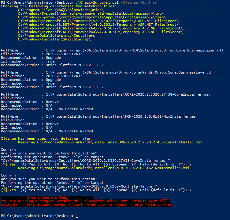

If you launch this script again with the recommended options, the ‘-Cleanup -Confirm’ process will again list affected components and prompt for confirmation before deletion of each affected file. After removing all files, the only remaining recommended action is to upgrade to the newest version.

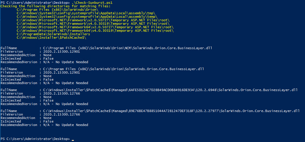

After upgrading, you can launch the script one more time to verify that there are no more known problems in your environment. Output should be similar to the following:
If script output is similar to the following (no recommended actions), there are no vulnerabilities present that this script was intended to detect.
