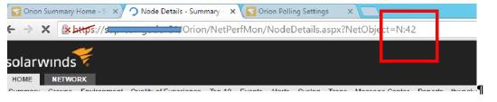

3. Open the Nodes details page and find the Node ID as per the example below

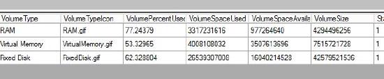

4. Run the following query on the Database to find the target Volume:
SELECT * FROM [dbo].[Volumes]
WHERE NodeID =42
You can now view the following information in the Volumes table, which will help determine if the alert we are receiving is false.
