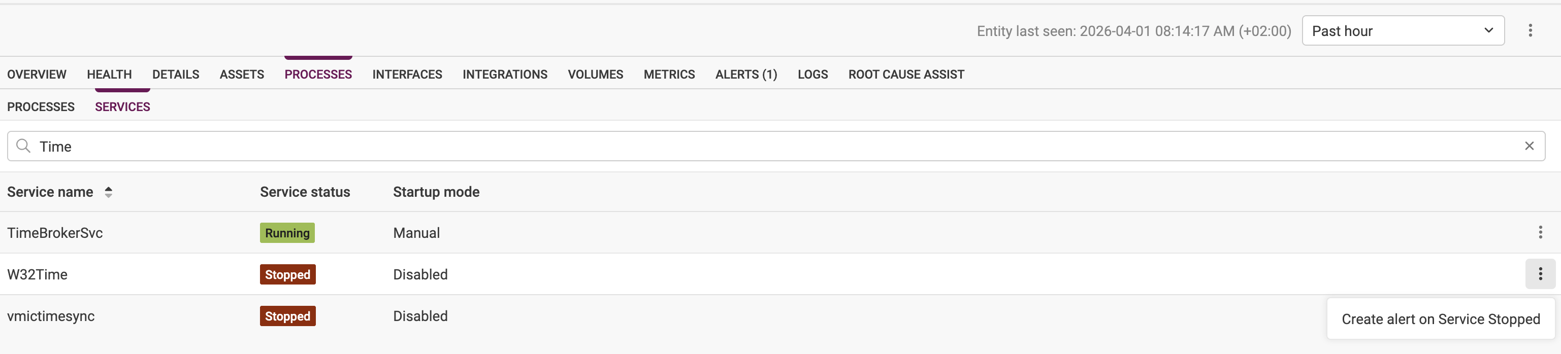

  3. For Windows hosts where you want more precise status monitoring of services, you can use the Services sub‑tab under the Processes tab in the entity details view and create an alert directly.
