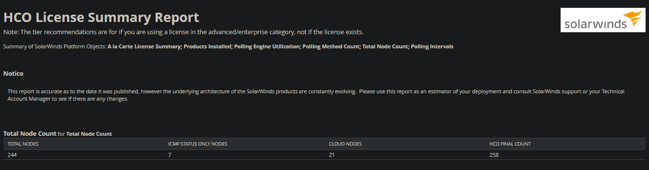

To review and clarify license consumption, run the OOTB report "HCO License Summary Report"
  1. Log in to SolarWinds Platform Web Console
  2. From the top menu, navigate to Reports > All Reports
  3. In the search bar, type in "HCO License". This will bring up the report.
  4. Click HCO License Summary Report
Sample Screenshot of the report:
This report will provide further explanation on how the licenses are being consumed.
