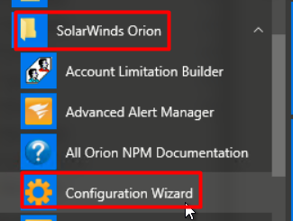

  3. Go to Start Menu > SolarWinds Orion folder > Configuration Wizard. Note that in newer versions, the folder name is SolarWinds Platform.
