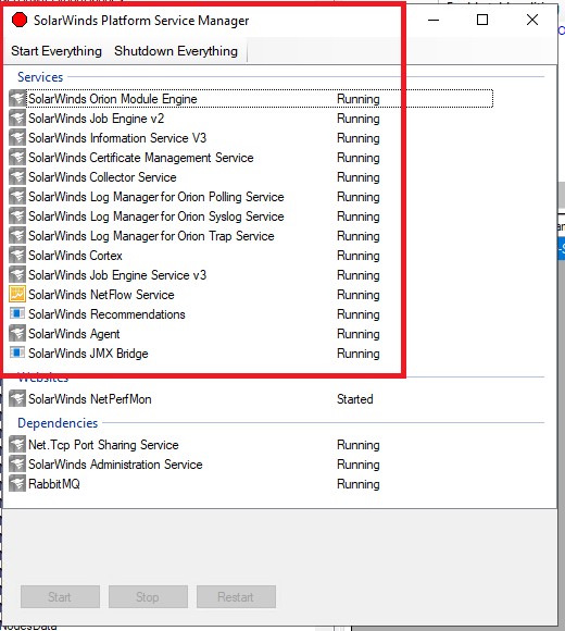

  4. Open SolarWinds Platform Service Manager and click Shutdown Everything. Confirm that all services under Services stop successfully.

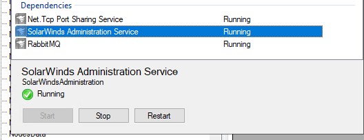

  1. In SolarWinds Platform Service Manager, under Dependencies, select SolarWinds Administration Service and click Stop.

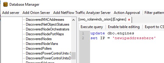

  3. Open Database Manager, click Add Orion Server, expand SolarWindsOrion, and double-click any table such as AccountRights to open a query window.
  1. Delete the default query and run the following SQL statement, replacing newipaddresshere with the new server IP address:
UPDATE dbo.Engines SET IP = 'newipaddresshere'
  1. Click Execute query.

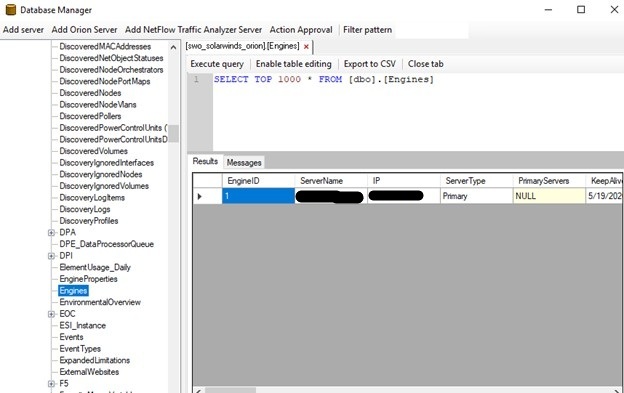

  1. Verify the change in Database Manager.

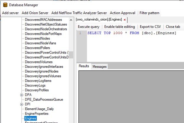

  • Under the SolarWindsOrion database, locate Engines and double-click it.
  • Run the query shown for the Engines table and review the Results pane.
  • Confirm that the IP column now shows the new IP address.
