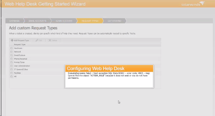

 In this issue, the Web Help Desk is unable to connect to MS SQL Server. When restarting the Web help Desk services, the Configuration Wizard opens the default browser and asks to configure the Database.
When trying to connect it's unable to read the Database data and seems a brand new setup. When proceed, getting an error:
EvaluateExpression failed: Next exception: SQL State:SO001 -- error code: 4902 -- msg:
Cannot find the object "ACTION_RULE because it does not exist or you do not have permissions.
Web Help Desk

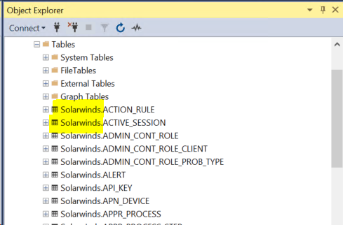

The Database schema is "Solarwinds" instead of "dbo".
The WHD database from the MS SQL Server is not using the default schema [dbo], causing the application unable to recognize the database data.

ALTER Schema dbo Transfer currentschema. <table name>
For example, the current schema is Solarwinds as shown below:
5. Run the query below to change to dbo
ALTER SCHEMA dbo TRANSFER Solarwinds.HISTORY_ENTRY
