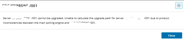

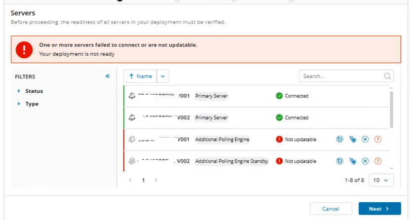

In Centralized Upgrade, one or more APEs or AWSs show status “No updatable”.
For at least one affected APE, the Upgrade/Pre‑flight screen shows an error similar to:
Server <poller_name> cannot be upgraded. Unable to calculate the upgrade path for server <poller_name> due to product inconsistencies between the main polling engine and <poller_name>.
Additional observations:
  • Main Polling Engine(s) appear as Connected and updatable.
  • APEs/AWSs appear as Not updatable or disconnected even though services are running.

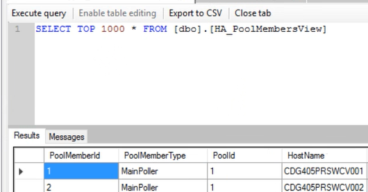

  • The HA_PoolMembers view in the SolarWinds Platform database may show two main polling engines marked Active or stale HA data for old pool members.

  • The upgrade service to see conflicting main poller references. From HA_PoolMembers table the 2xMPEs showing MainPoller on the PoolMemberType column.
  • In addition, in the registry of both servers showing MainPoller in RunType for High Availability.

  3. Confirm that:
    • Main Poller is Connected and upgradable.
    • All APEs and AWSs now show as Connected with valid upgrade options (no longer “No updatable”).
  4. Re‑run pre‑flight checks and confirm that the previous error:
    • “Unable to calculate the upgrade path…” no longer appears for any APE/AWS.
