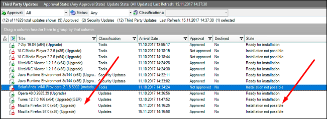

You may also see packages in the console getting published, but the state of the packages is Failed to Download / Installation Not Possible.
