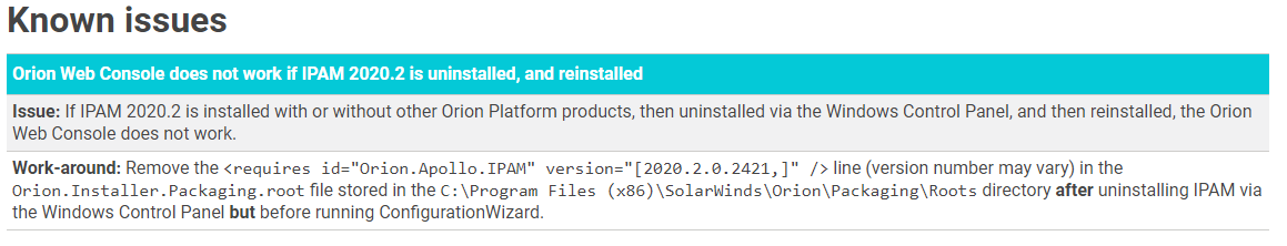

Note: For IPAM 2020.2 after you have uninstalled and reinstall it and the web console does not work or you are getting "Menu failure", please follow the workaround below. This is a known issue with IPAM and this is indicated in the IPAM 2020.2.1 release notes.
