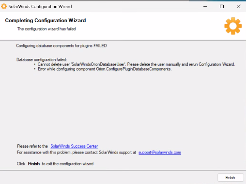

When running the SolarWinds Configuration Wizard – Database step, the wizard can fail with “Cannot delete user 'SolarWindsOrionDatabaseUser'. Please delete the user manually and rerun Configuration Wizard.”

From Configuration Wizard > Database:
  • Error:
    Database configuration failed:
    • Cannot delete user 'SolarWindsOrionDatabaseUser'. Please delete the user manually and rerun Configuration Wizard.
  • The wizard stops on the database configuration step and does not complete.
