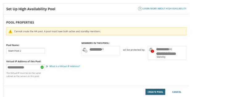

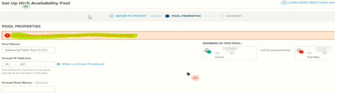

When setting up a High Availability (HA) pool via web console, you can see the following error message:
Cannot create the HA pool. A pool must have both active and standby members.
And upon checking the HA_PoolMembers table we see two Old Pool Member showing up as Main Poller still exists, but the same members to not exists in OrionServers Table.
Similar error pops up while Creating/Editing a HA Pool
