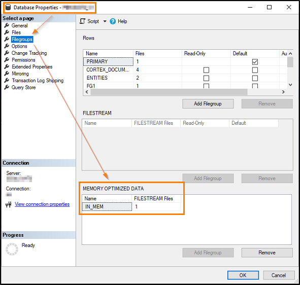

Error 1: Cannot Create Memory optimized tables
  1. Open SQL Server Management Studio (SSMS) ™, ensuring the credentials used on the SQL Server have SA privileges and DBO permissions on our DBs.
  2. Check the state of the database file groups (right-click the database > Properties > Filegroups).
  3. There should be a row under the MEMORY OPTIMIZED DATA section, and the FILESTREAM Files column should be 1. If it is set to 0, it means the in_mem1 file is missing.
This can be further verified by checking the Files page of the same database properties window.
  1. Remove the file group under the database file groups (right-click the database > Properties > Filegroups > MEMORY OPTIMIZED DATA) by selecting the group (IN_MEM) and clicking the Remove button.
  2. Re-add the file group under the database file groups (right-click the database > Properties > Filegroups > MEMORY OPTIMIZED DATA) by clicking the Add Filegroup button and entering IN_MEM as the Name.

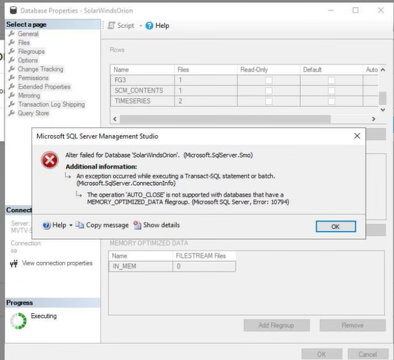

    1. In case the error below is encountered, set the value of AUTO_CLOSE to False (right-click the database > General > AUTO_CLOSE)

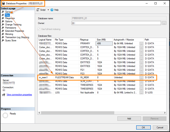

  3. Add the file to the created file group (right-click the database > Properties > Files) by clicking Add and using the details as in the example below.
  4. To verify, check the file group under the database file groups (right-click the database > Properties > Filegroups > MEMORY OPTIMIZED DATA).
  5. Re-run the Configuration Wizard.

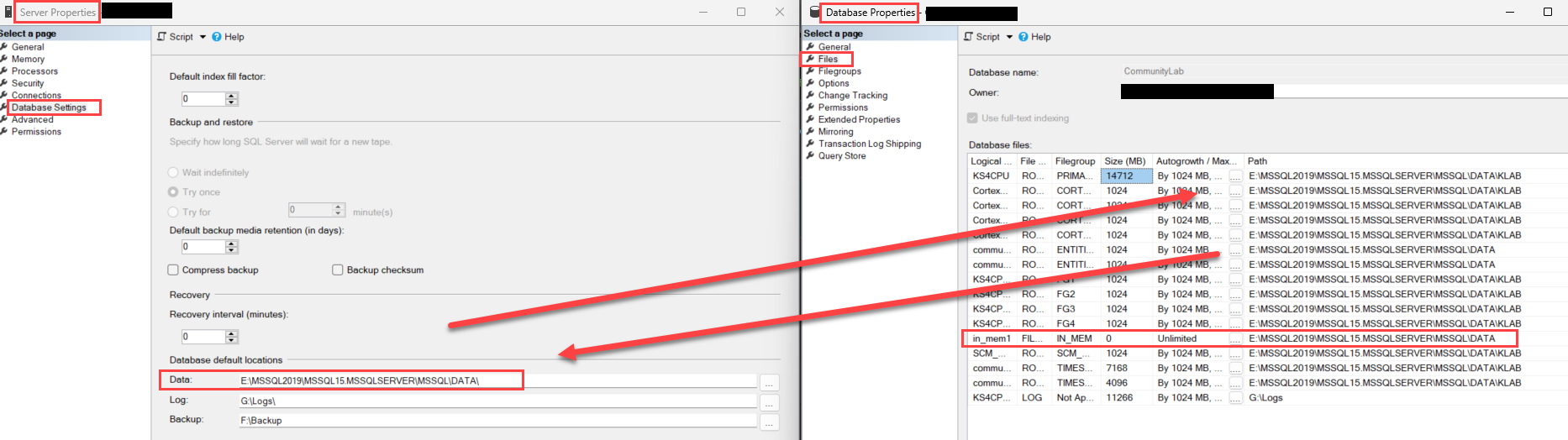

Error 4: The code generation directory cannot be created or set up correctly
  1. Compare the Server Properties "Database default locations" with that of the in_mem1 files path via the Solarwinds Database Properties.
If they differ dramatically, update the "Database default locations" in the Server Properties to match the path of the in_mem1 file (This will often require the SQL Server instance be restarted).
Server Properties:
SSMS > right click the SQL Server Instance node > Properties > Database Settings > Database default locations
Database Properties:
SSMS > right click the SolarWinds database > Properties > Files > in_mem1 file > Path column
2. Re-run Configuration Wizard
