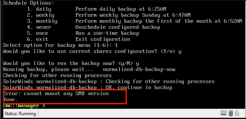

While upgrading your SEM(Formerly LEM) appliance OR during scheduled daily backups you may see following error(s)
Mount error (13) Permission denied.
OR
And in mgrconfig.log on the SEM appliance
2020-12-21 17:10:02 [Backup.pm:113 #2297] SolarWinds normalized-db-backup : OK, continue in backup
2020-12-21 17:10:02 [SmbMount.pm:246 #2297] trying mount smb versions: autoNegotiate, 3.11, 2.0, 1.0
2020-12-21 17:10:02 [SmbMount.pm:262 #2297] smb version 'autoNegotiate' failed: smb error: mount error(13): Permission denied Refer to the mount.cifs(8) manual page (e.g. man mount.cifs) at /etc/perl/Lem/SmbMount.pm line 284.
2020-12-21 17:10:02 [SmbMount.pm:262 #2297] smb version '3.11' failed: smb error: mount error(13): Permission denied Refer to the mount.cifs(8) manual page (e.g. man mount.cifs) at /etc/perl/Lem/SmbMount.pm line 284.
2020-12-21 17:10:02 [SmbMount.pm:262 #2297] smb version '2.0' failed: smb error: mount error(13): Permission denied Refer to the mount.cifs(8) manual page (e.g. man mount.cifs) at /etc/perl/Lem/SmbMount.pm line 284.
2020-12-21 17:10:02 [SmbMount.pm:262 #2297] smb version '1.0' failed: smb error: mount error(112): Host is down Refer to the mount.cifs(8) manual page (e.g. man mount.cifs) at /etc/perl/Lem/SmbMount.pm line 284.
2020-12-21 17:10:02 [sysconfig:47 #2297] cannot mount any SMB version at /etc/perl/Lem/SmbMount.pm line 270
