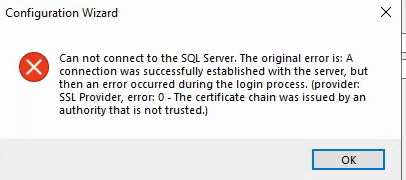

Cannot connect to the SQL server. The certificate chain was issued by an authority that is not trusted.

The following error appears when SSL is enabled on the client's SQL Configuration Manager.
Cannot connect to the SQL server. The original error is: A connection was successfully established with the server, but then an error occurred during the login process. (provider: SSL Provider, error:0 - The certificate chain was issued by an authority that is not trusted.)
Orion Platform
  • SSL encryption is enabled on the SQL server and/or the certificate on the SQL server is not trusted by the Polling Engine.
  • Authentication by SQL server is not enabled.
  • Multiple SQL Instances.

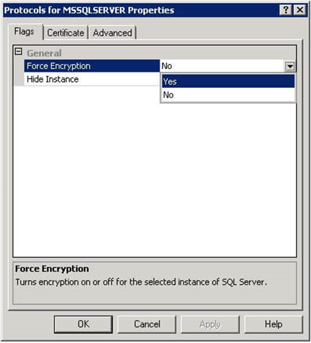

Configuring SQL Server to accept encrypted connections

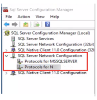

You can configure SSL using the SQL Server Configuration Manager. First, you should run SQL Server Configuration Manager under the SQL Server service account. The only exception is if the service is running as LocalSystem, NetworkService, or LocalService, in this case, you can use an administrative account.
1. Expand SQL Server Network Configuration and right-click on Protocols for <YourMSSQLServer>, then click Properties.
2. On the Certificate tab, select the certificate you would like to use.
3. On the Flags tab, select Yes in the ForceEncryption box, then click OK.
4. Restart the SQL Server service.

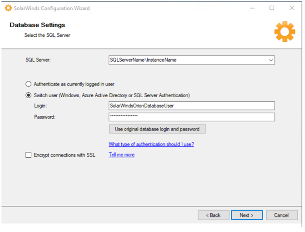

If there are multiple SQL Instances, enter the <SQLServerName\InstanceName> in the Configuration Wizard.
