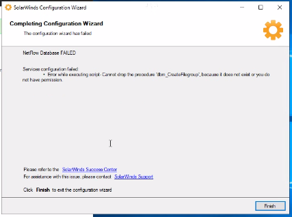

"Cannot drop the procedure 'dbm_CreateFilegroup', because it does not exist or you do not have permission" error in the Configuration Wizard when upgrading to SolarWinds Platform 2025.2
During an upgrade to version 2025.2, the Configuration Wizard (CW) may show the following persistent error: "Cannot drop the procedure 'dbm_CreateFilegroup', because it does not exist or you do not have permission."
This error prevents successful completion of the upgrade to 2025.2. The Configuration Wizard fails with the below message, indicating either a permissions issue or a mismatch in the database schema.

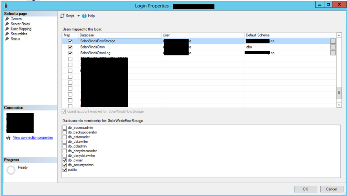

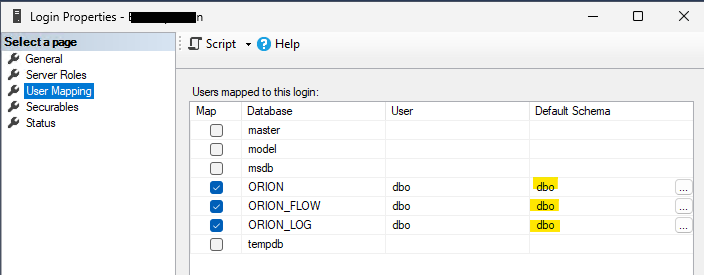

- If the account permissions are correct but the error persists, check the schema ownership of the database objects involved.
- Ensure the schema is set to
dbofor the proceduredbm_CreateFilegroupand related objects. You can verify and change the schema using SQL Server Management Studio (SSMS) with commands similar to:
ALTER SCHEMA dbo TRANSFER [schema_name].[dbm_CreateFilegroup];
Replace [schema_name] with the current schema name if different from dbo.
