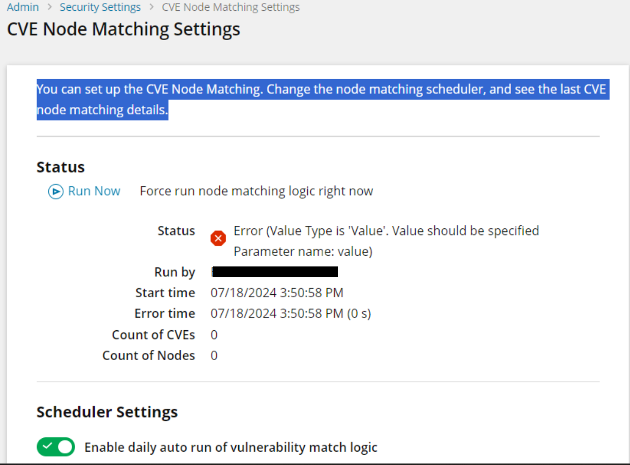

User runs CVE Node Matching tool in NPM and getting the error:
Error (Value type is 'Value'. Value should be specified Parameter name: value)
This issue may occur in some VMWare vCenter environments. Replication was done with vCenter Server v6.7.0.

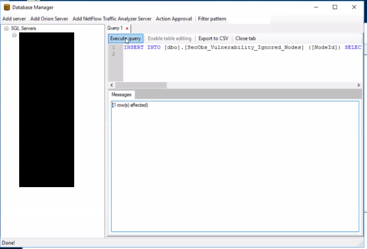

To resolve this issue, please upgrade to SolarWinds Platform 2024.4 and above. If upgrade is not possible, perform the following steps to as a workaround:
-- Scripts are not supported under any SolarWinds support program or service. -- Scripts are provided AS IS without warranty of any kind. SolarWinds further -- disclaims all warranties including, without limitation, any implied warranties -- of merchantability or of fitness for a particular purpose. The risk arising -- out of the use or performance of the scripts and documentation stays with you. -- In no event shall SolarWinds or anyone else involved in the creation, -- production, or delivery of the scripts be liable for any damages whatsoever -- (including, without limitation, damages for loss of business profits, business -- interruption, loss of business information, or other pecuniary loss) arising -- out of the use of or inability to use the scripts or documentation. INSERT INTO [dbo].[SecObs_Vulnerability_Ignored_Nodes] ([NodeId]) SELECT [vcenter].[NodeID] FROM [dbo].[VIM_VCenters] AS [vcenter] LEFT JOIN [dbo].[SecObs_Vulnerability_Ignored_Nodes] AS [ignored] ON [vcenter].[NodeID] = [ignored].[NodeId] WHERE [ignored].[NodeId] IS NULL AND [vcenter].[VMwareProductName] = 'VMware vCenter Server'
NOTE: Backup the database before executing.

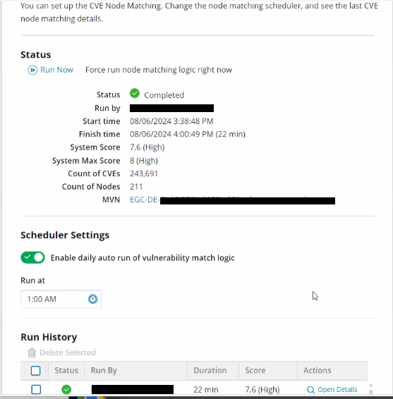

Then go to Settings > All Settings > Security Settings > CVE Data Import Settings and then RUN the job to download the CVEs.
Then proceed to go to CVE Node Matching Settings and click Run and it should work.
