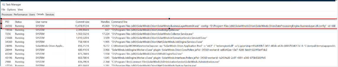

The SolarWinds Platform Server is experiencing high Memory usage with SolarWinds.BusinessLayerHostx64.exe processes until services had to be restarted.
SolarWinds.Orion.DataProcessingEngine.BusinessLayer plugin was not loading in BusinessLayerHost. Instead, it entered a continuous crash loop with a System.TypeLoadException, and the DPE BusinessLayer log remained empty because the plugin never successfully started or re-registered with Service Directory.
