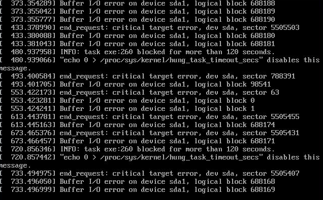

SEM displays the following error when booting and drops to an initramfs(.busybox) prompt: Buffer I/O error on device sdaX, logical block XXXXXX The issue still persists even after SEM is rebooted and the root login prompt is not displayed. The only way to access SEM is through the Console directly from VMware/Hyper-V.
Security Event Manager (formerly Log & Event Manager) displays the following error when booting and drops to an initramfs(.busybox) prompt:
- If rebooting SEM does not prompt you to log in as root to manually run fsck, reboot the host and run a disk check. Refer to your Hyper-V or VMware documentation on how to monitor failing disks.
- Refer to Boot drops to a (initramfs) prompts/busybox (© 2017 Stack Exchange Inc, available at https://askubuntu.com/, obtained on June 23, 2017.) to identify and repair the bad superblock or sector.
