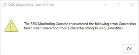

When opening the Monitoring Console, you are presented with the following warning message:
The SSIS Monitoring Console encountered the following error: Conversion failed when converting from a character string to uniqueidentifier.

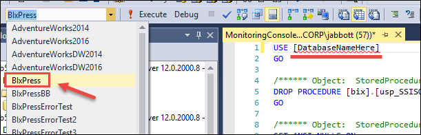

Step 2: Open SQL Server Management Studio.
Step 3: Copy/Paste the T-SQL Script below into a new query window.
Step 4: Select the BIxPress database that is throwing the error.
Step 5: If utilizing the USE statement, then update it to reflect the correct BI xPress Database – if selecting it from step four above, you can exclude the USE and GO on the first two lines when you run the script.
Step 6: Execute Script.
Step 7: Open Workbench, and Open the Monitoring Dashboard – problem solved.
