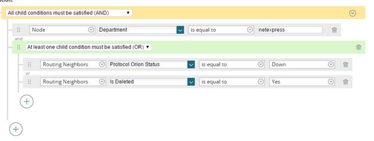

An alert created for BGP if it goes down or the neighbor is missing is not firing correctly, where the alert was created for nodes where the custom property is using a specific value.
Network Performance Monitor
Incorrect Trigger Condition
1. Use either - is equal to OR contains - <Specific value> when using a Custom Property to trigger on Nodes on a BGP Alert (Not equal to OR Does not contain may not work).
2. Make sure the Nodes to be triggered have the correct Custom Property value <Specific value>. You can check the values on Settings > All Settings > Manage Custom Properties
Use SWIS http://servername/Orion/admin/swis.aspx to confirm that those are expected to be triggered.
Add an action to send an email, and add a variable so it will tell you the following:
Node Name
Neighbor IP
Neighbor status
Neighbor state
Is Missing
Save the alert and confirm it triggers as expected.
