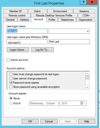

Screenshot of the account in Active Directory:
Security Event Manager
The principle name is not fully qualified in Active Directory and it causes the error.

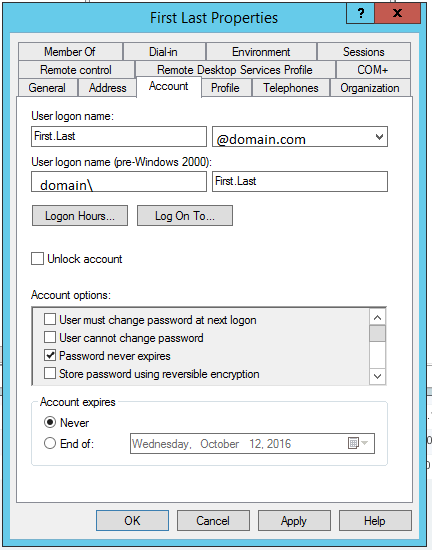

First, make sure you are running at least 6.3.1 Hotfix 2 in SEM. There are fixes related to LDAP login issues in the hotfix. If you're still having issues, try the following steps.
  1. Find the account in Active Directory.
  2. Edit the account.
  3. Click the Account Tab.
  4. From the drop-down list to the right of the User logon name, select the domain the account belongs to.
    Correctly configured account:
