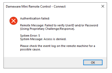

There are instances in which, although Username and Password are correctly configured in the Agent, error message as below is being encountered:
Authentication failed: Remote Message: Failed to verify UserID and/or Password (Using Proprietary Challenge/Response). System Error: 5 System Message: Access is denied. Please check the event log on the remote machine for a possible cause.
