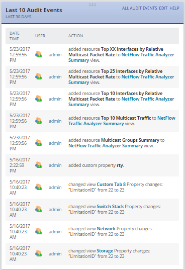

When performing maintenance mode on the node details page, After clicking the maintenance mode or mute alerts. it does not reflect right away on the audit events.

  6. Select Unmanage node or Mute Alert for a test.
  7. Check the Audit Events resource and database table.
