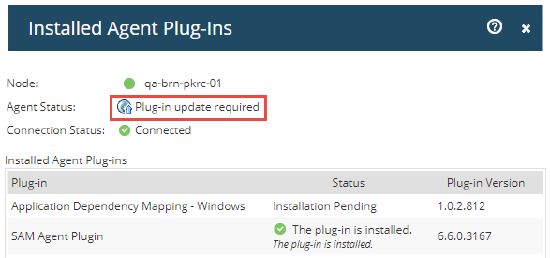

SAM deploys agent plug-ins to nodes when Application Dependency polling detects interaction between an application and/or application process and a node. If the Allow Automatic Agent Updates option is disabled for the Orion Platform, SAM cannot deploy agent plug-ins to server nodes and the status of the agent appears as "Plug-in update required" on the Manage Agents page.

If the Allow automatic agent updates option is not enabled on the Agent Settings page, SAM cannot deploy agent plug-ins to server nodes when Application Dependency polling detects a connection between an application and a node. The status of the agent changes to "Plug-in update required" on the Manage Agents page.

If the Allow Automatic Agent Updates option is disabled on the Agent Settings page in the Orion Web Console, SAM cannot deploy agent plug-ins to server nodes and the status of the agent appears as "Plug-in update required" on the Manage Agents page.
To resolve this issue for future agent plug-in updates, consider enabling the Allow Automatic Agent Updates option on the Agent Settings page. Otherwise, you can update agent plug-ins manually in the Orion Web Console.
  1. Navigate to the Settings > All Settings > Manage Agents page.
  2. Select the agent(s) and click More Actions > Update.
