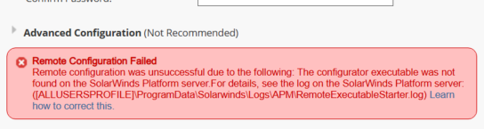

After upgrading to version 2025.2.1, when clicking on Configure Exchange the following error displays:
Remote Configuration Failed
Remote Configuration was unsuccessful due to the following: Unable to access remote administrator share. see the log on SolarWinds Platform server:
([ALLUSERSPROFILE]\ProgramData\SolarWinds\Logs\APM\RemoteExecutableStarter.log)
Or
Remote Configuration was unsuccessful due to the following: The configurator executable was not found on the SolarWinds Platform Server. see the log on SolarWinds Platform server:
