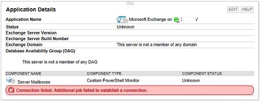

The following error occurs in the Application Details page: Connection failed. Additional job failed to establish a connection.

The error is caused by either of the following:
  • A timeout during an Initial Poll on large Appinsight Deployments.
  • On the initial poll, all the mailbox statistics are polled which can be a heavy polling job and can result in a timeout or causing other components to timeout.
  1. Unmanage the application for a couple of minutes and Remanage it again.
  2. Click Poll Now.
  3. The job will now be queued and a polling job will be initiated.
  4. Allow a minute or two for the job to complete and the error should clear.
