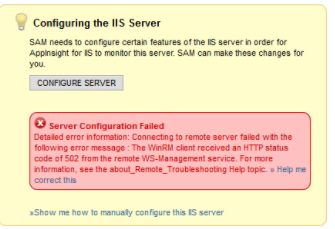

When attempting to run Automatic Configuration on AppInsight for IIS, the following error appears:
Server Configuration Failed
Detailed error information: Connecting to remote server failed with the following error message: The WinRM client received an HTTP status of 502 from the remote WS-Management service.
