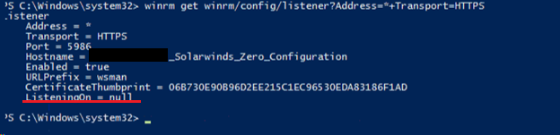

The WinRM Service on the Exchange Mailbox is not listening on any IP addresses.
Confirm the configuration on the Exchange Server
  1. RDP to the Exchange Server that you are attempting to register for monitoring.
  2. Open a PowerShell session.
  3. Run the following command
    winrm get winrm/config/listener?Address=*+Transport=HTTPS
  4. Confirm that ListeningOn lists IP addresses that it is listening on. It SHOULD NOT have "null" like the image below:

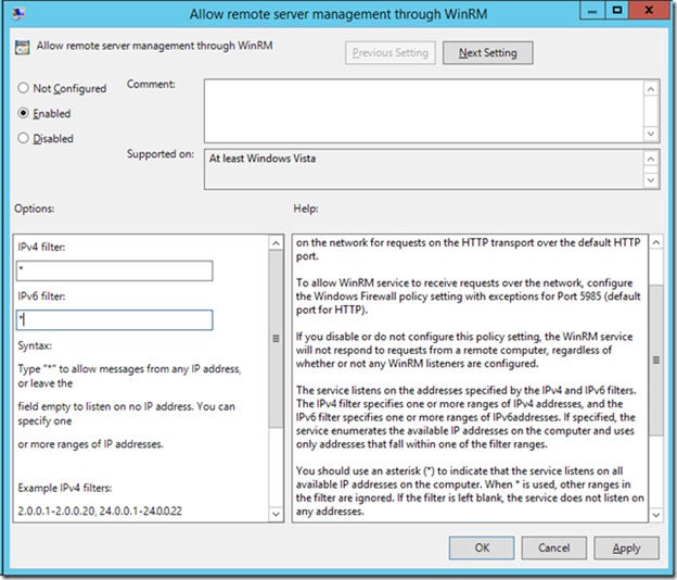

If you have the same as the above image, then this issue can be caused by an incorrect Group Policy Configuration.
Confirm the following in your Group Policy
  1. Open your Group Policy Editor.
  2. Go to Computer > Policies > Windows Components > Windows Remote Management (WinRM) > WinRM Service.
  3. Check the configuration of the "Allow automatic configuration of listeners" policy.
  4. Verify that the Policy configuration is correct.
Note: There should not be quotes entered into the fields available. The configuration should look like the following:
If you need to change this policy, you will need to force a Group Policy Update on the Exchange server and try running the AppInsight Configuration from SAM again.
