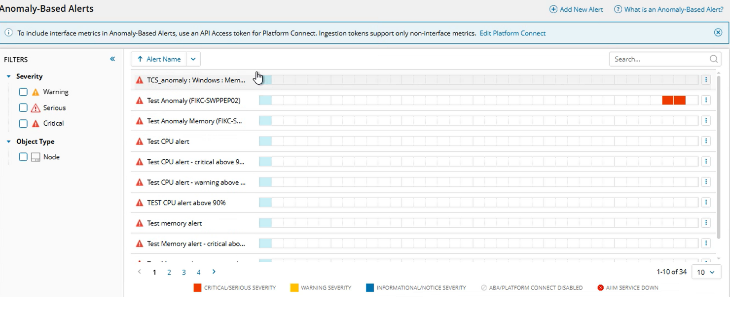

Anomaly Alerts are not being sent to the Cloud and the charts remains empty in SolarWinds Platform
Even if the Platform Connect is connected, the Anomaly Alerts data are not being populated.

After using Platform Connect to connect to the SolarWinds Observability Cloud, the Anomaly Based Alerts are not being populated.
Only the alerts that are using "Trigger when Anomaly Detection service unavailable" option can get datapoints in the chart.
It happens because the data is in the SQL Database, not in the cloud.
