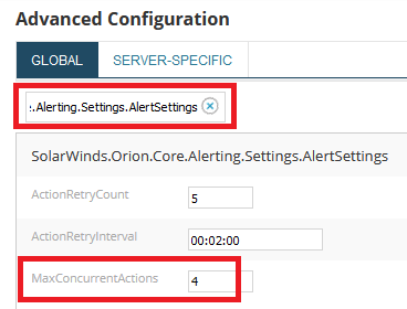

To increase the action execution parallelism you can follow the steps below:
  1. Go to http://your-orion-page/Orion/Admin/advancedconfiguration/global.aspx
  2. Search SolarWinds.Orion.Core.Alerting.Settings.AlertSettings.
  3. Increase MaxConcurrentActions from 4 to 12:

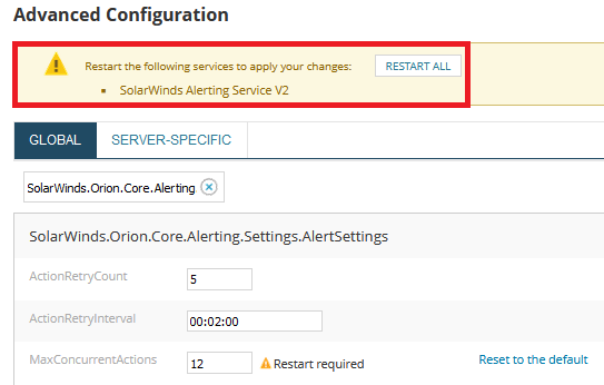

  4. Save the change and then click Restart All to restart the alerting service:
