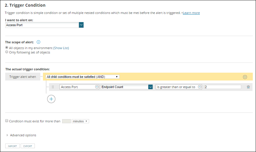

  1. Verify the trigger action and make sure that it is similar to the below screenshot.

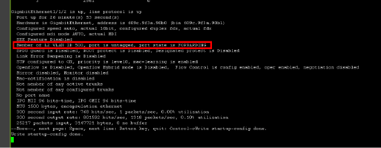

  3. Telnet to the device then type the command: show interface,make sure that the port is tagged or is configured as access port.
    This illustration shows untagged port, which is considered as trunk port.
