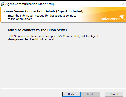

  • During installation of Orion Agent, you see below error

  • Agent Management Service is not started or plugin disabled for some reason
Resolution 1:
Launch Orion Service Manager and ensure "SolarWinds Agent Service" is running. If service is running but still having issue, then follow rest of the steps below.
  1. Run Notepad as Administrator.
  2. Open the following file:
    \solarwinds\orion\agentmanagement\Solarwinds.AgentManagement.ServiceCore.dll.config
  3. Find the following line:
    <SolarWinds.BusinessLayerHost LoadPlugins="false">
  4. Change it to the following:
    <SolarWinds.BusinessLayerHost LoadPlugins="true">
  5. Stop and start the Orion Module Engine service.
