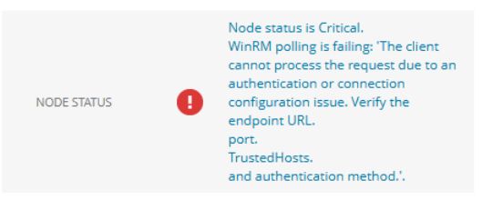

After upgrading to SolarWinds Platform 2026.1 and upgrading the agent on the additional web server, the out-of-the-box Node polling failing alert starts firing for that node, even though the node still returns some statistics in SolarWinds. On the node detail page, it displays this error:
Agent logs show WinRM/WMI query failures against Win32_PerfRawData_PerfProc_Process, indicating a problem with the underlying PerfProc performance counters on the server.
